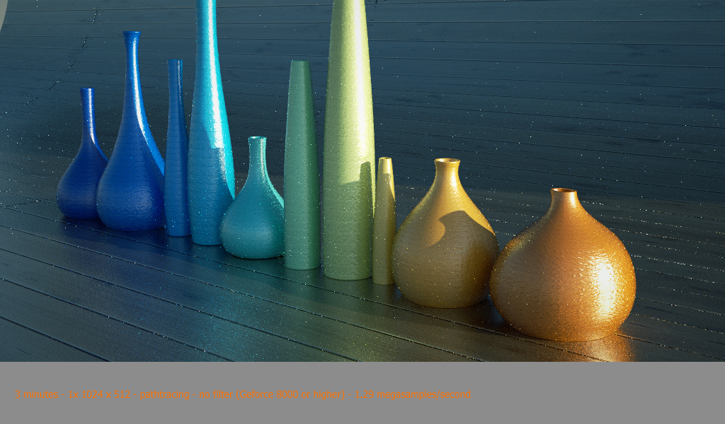

Attached a scene that rendered for 3 minutes, using path tracing.
The first 2 images show a straight render with and without filtering.
The 3rd image uses this technique, it has nearly no fireflies, smooth antialiasing, does'nt require a 9000 or higher GPU, and renders faster.
No manual firefly removal is needed nor any tools like hotpixels. (although running hotpixels on the 4x resolution one would be good aswell)
