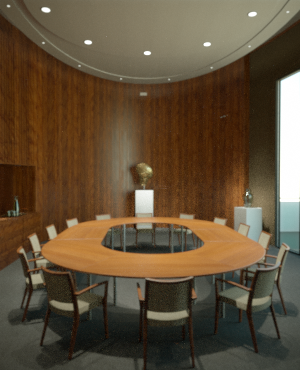

after some time testing with simple geometry I´d like to get a more complex scene to work with octane. But I am confused since after 7,5h rendering the picture is far from beeing cleared even in uniform non specular areas. Maybe someone could have a look at my specs and at the picture and give some impression whether the times are plausible.
I did the pic on pathtracing kernel and let it render to 64.000 s/px
Cheers,
Rogurt

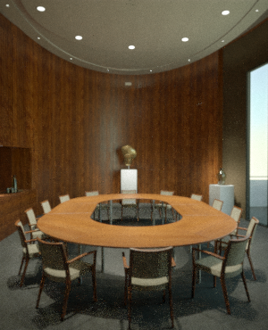

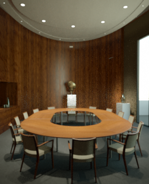

thank you guys for your advice. I made some testing and maybe you´re interested in the results.
I tried to tweak the kernel settings as to give indirect lighting more processing time and to have more paths evaluated than going too deep into single paths. Next I tried to add portal and further tweak the sampling settings of the spot emitters (IES) on the ceiling.
In short: portal does a really good job - noise of environmental lighting gets reduced quite well
tweaking sampling time of bright spots does the rest - shadows and lighting in according zones are way better (less grainy).
So most of the time I think one can spare the fumbling in the kernel except for the bounce depths..
But see yourself
1 all settings default except for depth=6 alphashadows=off
2 exploration strength from 0.7 to 0.15 -> grainier less fireflies
3 exploration strength from to 1.0 -> more noise and more fireflies than initial setting (0.7)
4 direct light importance set from 0.1 to 0.02 -> again more noise than initial setting and more fireflies
5 simple plane portal used in front of windows -> way less noise
6 tweaked sampling of main Spots in ceiling -> less noise in spot lit areas/shadows

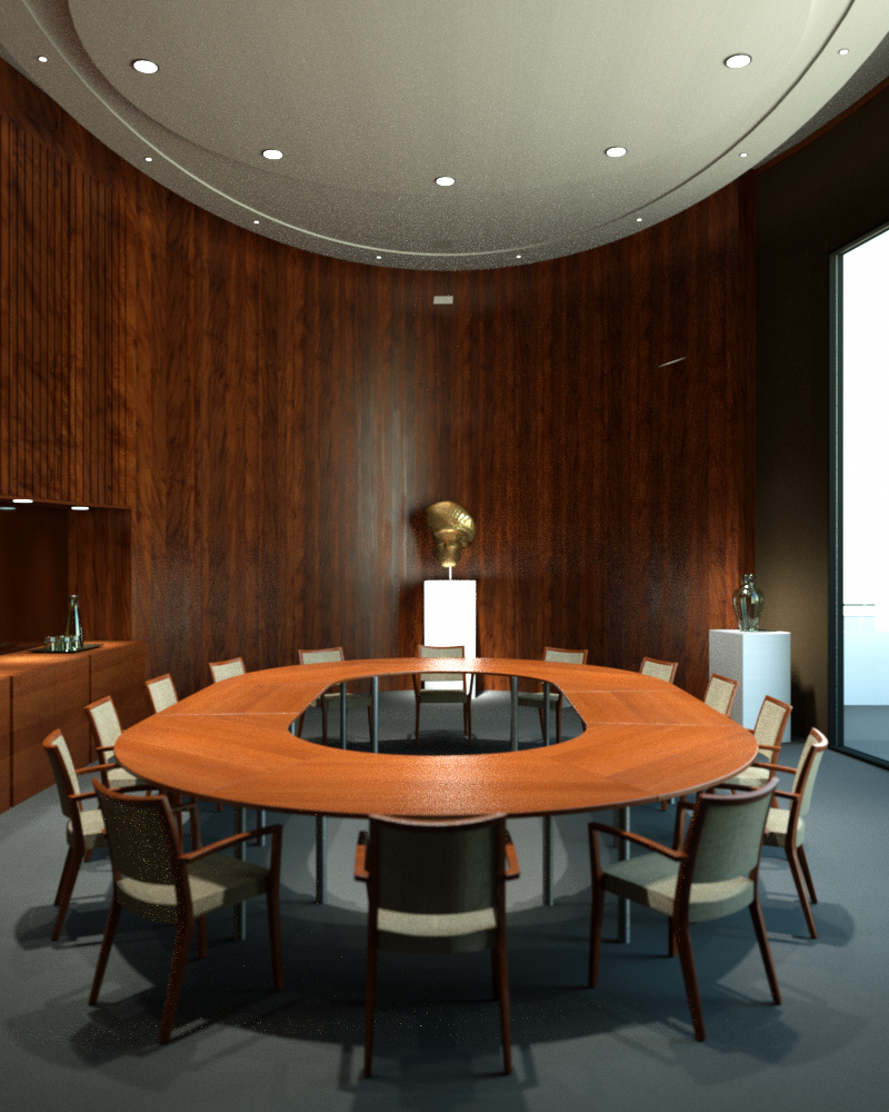

thanks for the advice. it really shows less noise when calculating for the same time with 3 times resolution than downsampling to original size (PSD standard filter). In addition the picture is remarkably sharper with more details where small dark features stand in front of a very bright background.
So that seems to be a really good thing to do...
I must correct my remarks on test #5. The portal does not seem to give remarkable noise reduction in that scene compared to standard setting (#1). Must have compared it to other pic than #1...
Edit: sample rendering attached

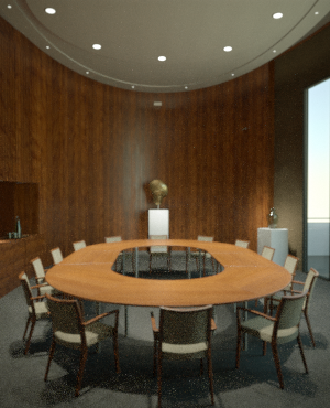

Edit: Pathtracing was the kernel here.
Thought Pathtracing would be a lot faster. But as it seems after 8.40min the picture is not as consistent as PMC version (compared to test #6). In some areas less noise (shadows on floor) but the fireflies give me some extra time in Photoshop. I already had the hotpixel removal reduced to the lowest value that wont let small picture parts vanish...
Is there some rule of thumb as: in interiour scenes with much indirect lighting pmc is superiour in terms of quality AND speed or the like?
What unbiased kernel do you guy prefer?

For completeness rendered again with direct lighting kernel. Result surprises me. While there´s less noise in indirect lit/shadow areas there are lots of fireflies in the render. Also I thought taht the overall appearance would differ from the two pictures due to completely different kernels. But it´s quite the same.
So the big final conclusion. Drop everthing but PMC? I remain confused.
Any help for orientation appreciated...
