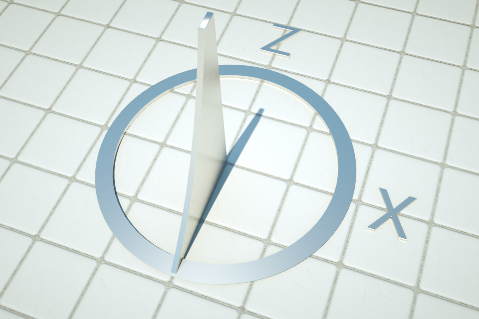

We may use Octane for visualization, but we need the lighting to be geographically accurate. What is Octane's north direction?
Thank you
t_3
Posts: 2871
Chris_TC wrote:We may use Octane for visualization, but we need the lighting to be geographically accurate. What is Octane's north direction?
Thank you
Z+ should be (if north offset is zero)
a little test... this photo taken from wikipedia (http://en.wikipedia.org/wiki/Sundial#Ho ... l_sundials):
and "rebuilt" in octane (using date, time and coordinates of the original photo):
