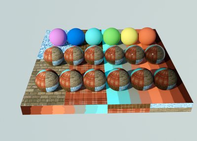

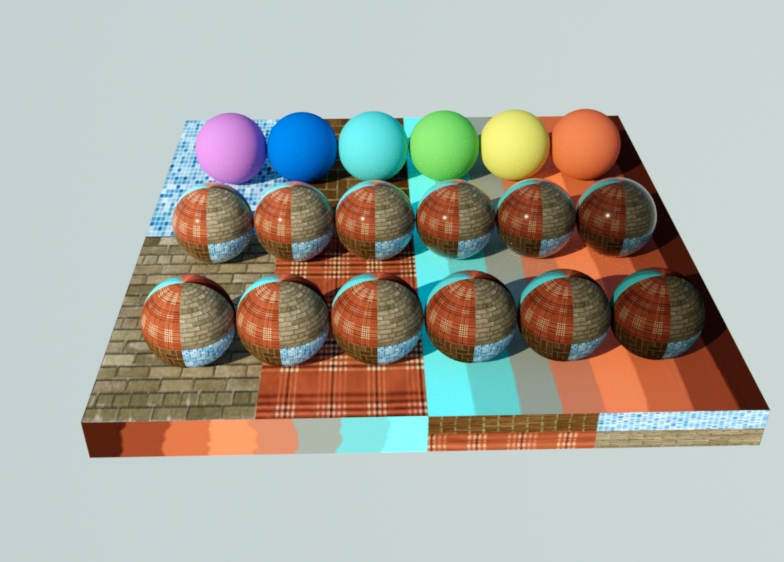

Needless to say reactivating both Octane and it's plugin work beautifully. As examples please see attached. Thank you for all the help Karba, GabrielFX, T_3 and roeland! Your guy's help is deeply appreciated!
