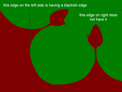

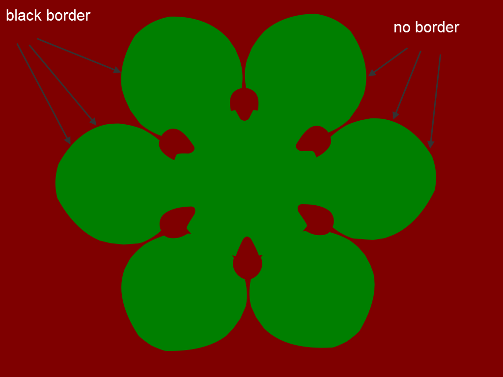

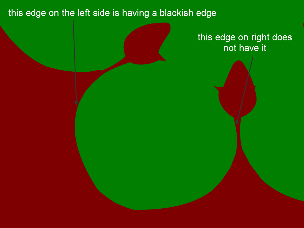

Issue: We have a strange black border (highly visible) coming in the Material ID channel. I tried many objects and many setups and its still present. Have a look at two attached images. It is more or less like appearing only on left side of intersections just like a shadow effect.

This is an effect of the RGB striping in your LCD display. If you zoom in you will see that the image doesn't actually contain a border. Or flip the image horizontally, and note how the black border is still on the left side of the red object, now on the side tagged with "no border".

You are right.. its related to my monitor.
