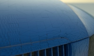

Wired, MentalRay looks ok here.
Funny is, a cube at origin 0,0,0 with 300k tris needs with MR 7sec, 100% CPU to render, is the origin at 50000,0,50000 the time is 1:30min, 100% CPU and the computer is nearly freezed...

gabrielefx wrote:I was wrong.
It's not an Octane bug.
vray, vray-rt, mentalray, iray, produce the same results.
I did another experiment: I modeled with Rhino two cubes of 10x10x10cm distant 10 kilometers to each other.
the first one was meshed well, the second one with approximate meshes.
But what happens if I create a tree 100 kilometers distant from the origin?
the world would explode. don't do it :lol:

hey GabrieleFx thanks for spotting this ...I was sitting here and wondering what the hell is wrong with my geometry when close to dispair I suddenly remembered browsing through this post of yours....
moved the model closer to the origin and all is good!

gabrielefx,
I'm with you. The last time I used OCTANE...which was months ago, I got the same result as you can see. I tried everything imaginable for days to make this work...scale, rayepsilon, rebuilding scene etc. Nothing worked! and It cost me

Can't Octane use double-precision FP?
Karba
Posts: 2300
GeorgeR wrote:Can't Octane use double-precision FP?
single precision is enough.
Problem is we use half precision for memory economy.
We should not do that.
