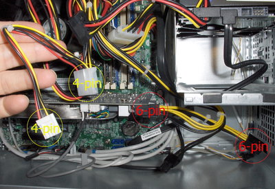

Anybody who can give me some advice on connecting cables for graphics card?
I'd like to upgrade to GTX 560 (most powerful card I can handle in my current computer) but it needs 2 x 6-pin connectors for power and I only have one (my current graphics card is using it now but I will use that one for the new card). However, there is another 6-pin connector attached to the one which is currently in use (see yellow/black cables between 6-pin connectors in photo). A potentially stupid question follows: Can I use that one as the second 6-pin connector? :oops:
If not... Together with the new graphics card comes a cable which makes one 6-pin connector out of 2 x 3-pin connectors. I have one white 4-pin connector available. Also one black 2-pin connector.
What do you suggest or am I screwed? :?

the 2nd 6pin connector is made exactly for that. it depends on the gpu and the power supply if a single lane is powerful enough to drive the card under load, but you will of course find this out. if not, the only thing that may happen is, that octane starts "failing" after some time in the rendering process. how powerful is your current psu?

t_3 wrote:the 2nd 6pin connector is made exactly for that. it depends on the gpu and the power supply if a single lane is powerful enough to drive the card under load, but you will of course find this out. if not, the only thing that may happen is, that octane starts "failing" after some time in the rendering process. how powerful is your current psu?
Hey, thanks for the quick reply, t_3. :)
My psu says max wattage 450W, and peak 500W. I have understood that this is enough for GTX 560, but GTX 560 Ti already needs 500W minimum. What do you think?

i currently drive a gtx 590 with a good quality 550w psu. as there are myriads of different power supplys, you will have to find out if the config runs stable or not, but in general i'd say it could work...
