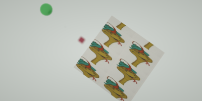

How do I delete Completely blur?
If you look at the picture, the small cube and the sphere Appear blurred.
I would not want this blur.
How it works?

Set the camera aperture to the smallest value.

I think rather than blur this is DOF ie the cube and sphere are out of focus.
Picking up on an old @abstrax post:
Q. How can i completely disable depth of field to create nice and crisp images without autofocus?
A. To disable DOF, set the aperture in the camera node to 0. To get a bit more crisp rendering, set the filter size in the kernel node to 1.25 or 1.3.

Grazie a tutti voi.
Risolto.
Thanks to all.
Resolved.
Set camera = 0
