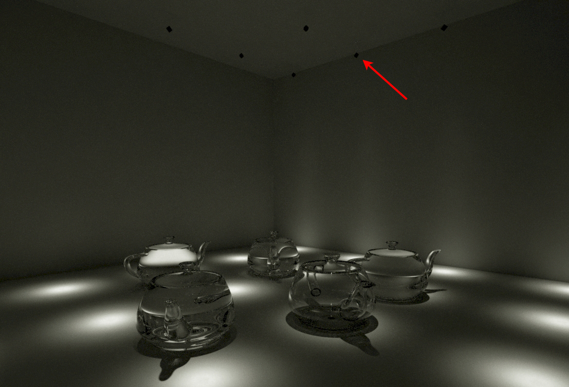

But at this state of develop these lights are unusable because the icon that represent them in the Max viewport is rendered.
Sometime is rendered white, sometime black.
I tried to create a white semitransparent disc and I put the ies light object behind. In this case I have to create holes on the ceiling but the computation time increase.

13) ies distribution should be rendered without that black hole in the center (see the example)

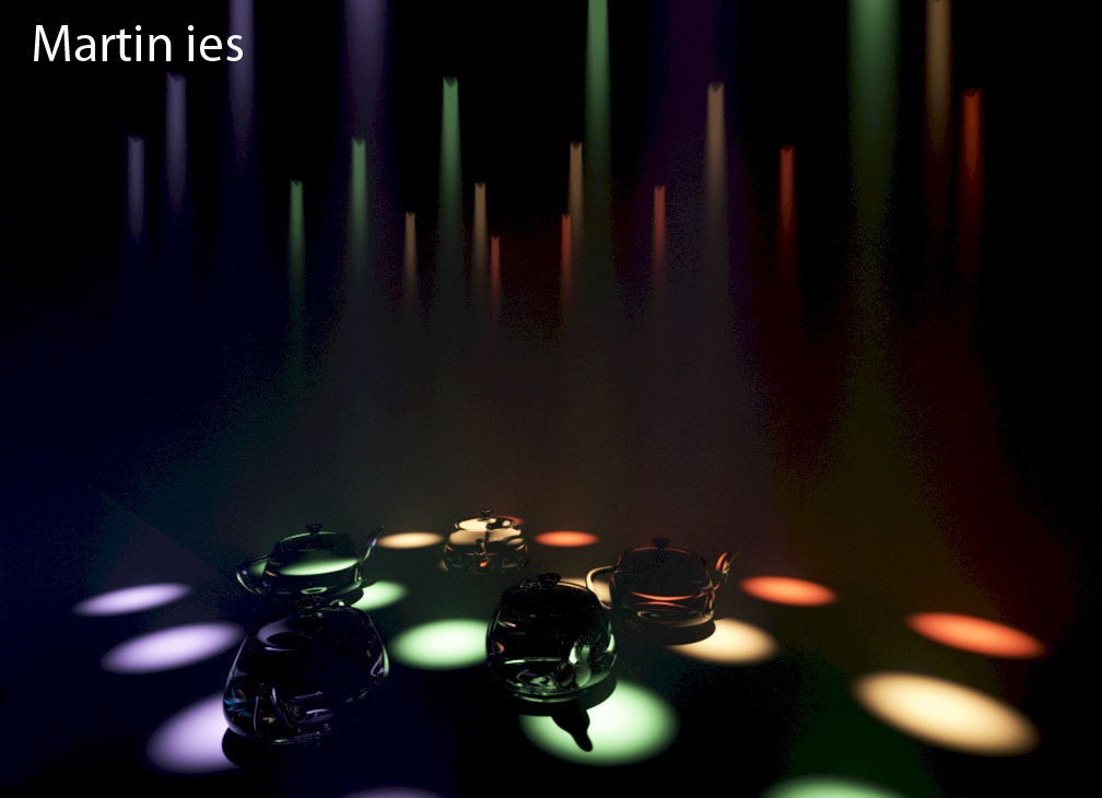

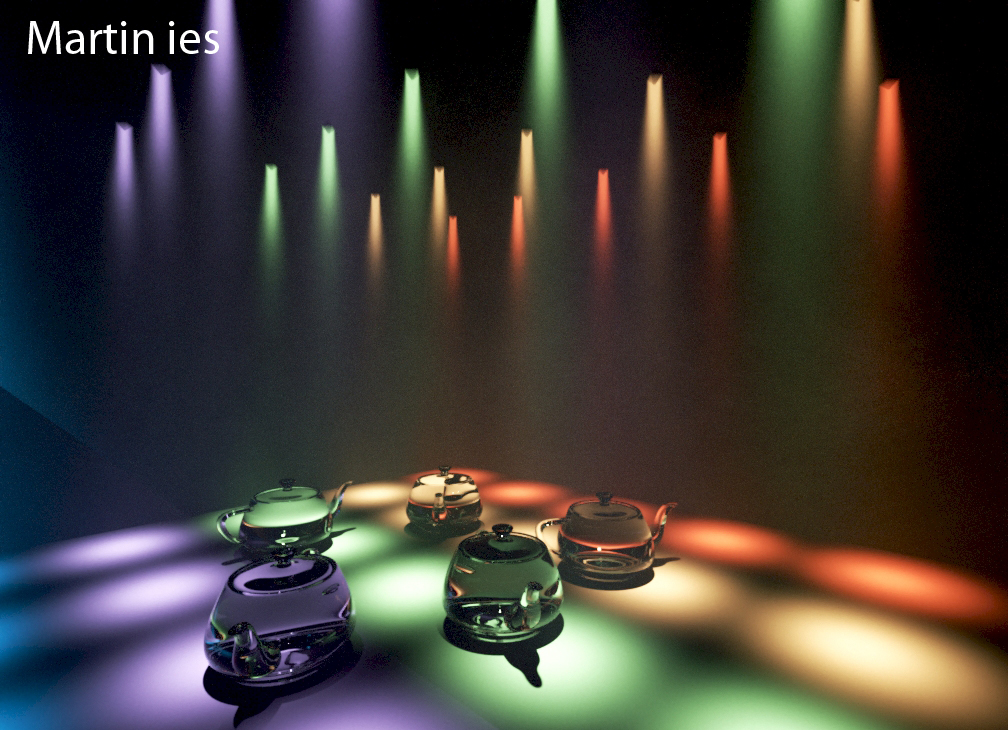

I attached here some example to show you what is possible to do with a participating media
