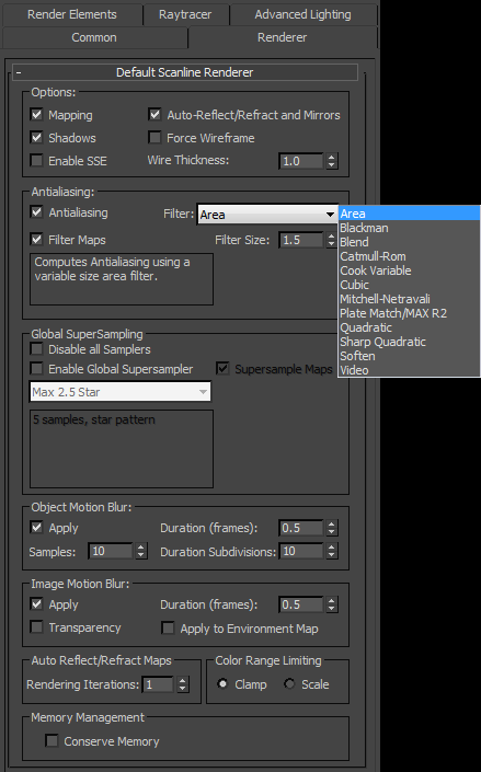

Can RS team, please suggest me which Anti-aliasing Filter (and filter size and other settings within the dialogue) I should use while generating render passes with scan-line render?
Please checkout the image attached.

Probably, you can use area filter with radius equal to kernel settings pixel blur.
But Octane contains DOF, so it is not easy to combine it.

* I do not use DOF in any of my renders, and I will surely try the area filter with filter size from kernel settings.
