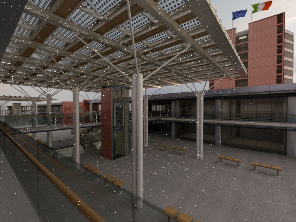

So, are these fireflies unavoidable when using HDR lighting ?

Fireflies HDR
These fireflies are here because of the lack of MLT currently.
You can improve by checking your roughness ammount on glossy materials (if lower than 120 = fireflies)

these are indeed normal, but the amount in your render is way too much,
so as Sam said, check your glossy materials roughness > 80 minimum and also see if you have any glass materials with wrong normals.
you should be able to find the culprit fairly quickly with some experimentation on the materials.
