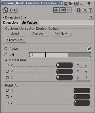

I think I am missing something..
I just checked now and the default upvector for camera like shown in the pic.
What exactly should I change?
face
Posts: 3204
Location: Germany
I mean the up-vector in Octane, not in SI ;)

plastiko
Posts: 9
Joined: Mon Nov 07, 2011 4:24 pm
thanks a lot!
