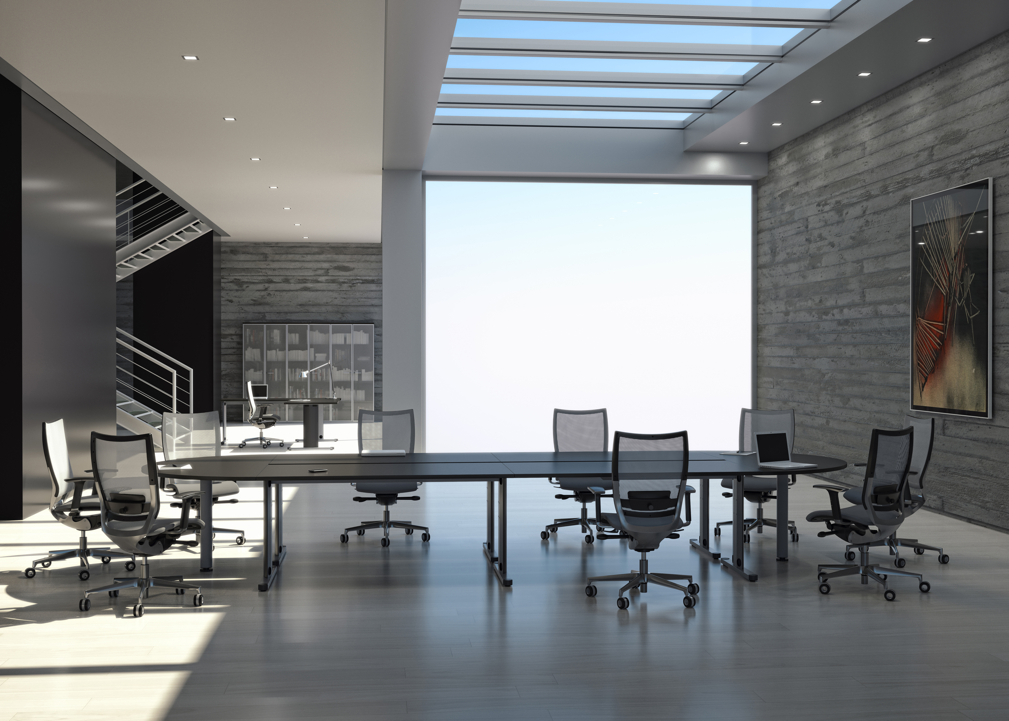

7000x5000 A3 printable half reduced,PT, 8hours render, scene large 2,6Gb, PS retouch

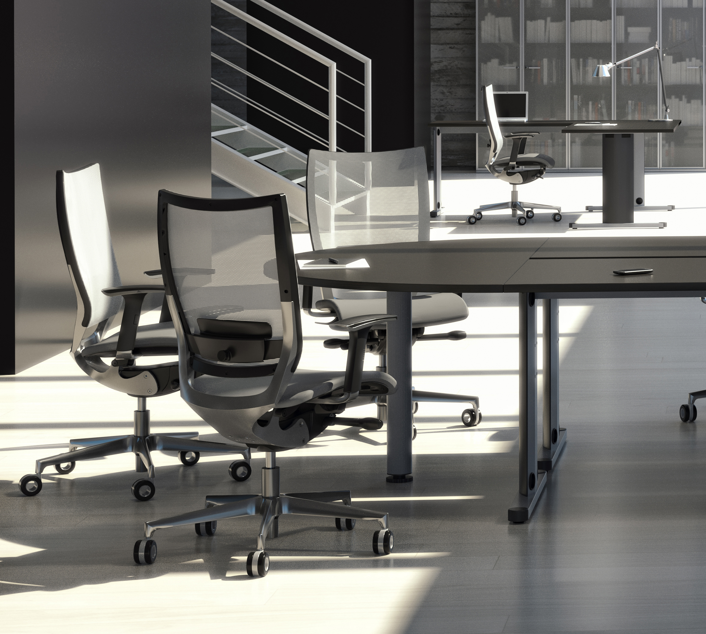

3500x2500 A4 printable half reduced,PT, 4hours render, same scene, PS retouch
added crop
4 GTX580 3GB used
I need instances...

Great job, congratulations! But after this long render I still see some dust (noise+micro fireflies). Why didn´t you use the PMC kernel?

yes I forgot to smooth many pieces because I used Deep Exploration to export the scene inside Octane.steveps3 wrote:Your table legs need smoothing.
The Max obj exporter always crashed.
I'll do new tests with pmc, but this method is 2x slower.
quad Titan Kepler 6GB + quad Titan X Pascal 12GB + quad GTX1080 8GB + dual GTX1080Ti 11GB
only the ms/sec count is lower; in many situations pmc samples converge faster, means less noise after the same amount of time than with pt...gabrielefx wrote:yes I forgot to smooth many pieces because I used Deep Exploration to export the scene inside Octane.steveps3 wrote:Your table legs need smoothing.

These renderings are a good reminder that weekend is there and we need to leave our desks - even if it is only for a few hours.
Put more work in the lighting and texturing.
There chair modeling is very good.

yes, in fact it's a test. It's a scene I did with max+vray and straight converted in Octane. I dedicated 1 hour to change some textures, nothing more.Refracty wrote:These renderings are a good reminder that weekend is there and we need to leave our desks - even if it is only for a few hours.

Playing with ies
the first image was rendered with PMC and Octane 2.52
3500x2500, 2,5 hours, 4 x GTX580, no photoshop
the second image was rendered with PT and Octane 2.55b2
7000x5000 half reduced (because the image is heavy to upload here), 8 hours, same hw, no photoshop
Statistics:
7 millions of triangles
2.075 GB occupied in the gpu ram
I wasn't able to renderize this scene with Arion 1.5.1 because the scene occupied 2,8GB (without textures and a lot of 3d book models)
Octane was able to load the scene with all books, 800Mb of obj file but not all textures were loaded (more of 400 materials). To bypass this limit every time I maintained pressed the return key to cancel the warning message (a filter would be appreciated)
