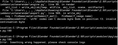

Finally I found this in the log:
Does that give you a clue?

You probably have a non-ascii character in some of your paths or filename. Neither Blender nor Octane take kindly to strange characters around here... :)
