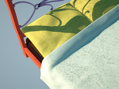

First time I see something like this happening when rendering a .3ds model I've downloaded and exported to .obj via 3DSMax.
Any ideas? Smoothing is enabled everywhere.

I would check the scene scale. Sometimes that will create the triangles when the scene is too large.

that was the problem, completely missed the scale!
thank you vm
