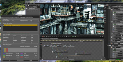

Hi Relox,
Sorry to hear that you are having issues.
I run a GTX 560ti on Win764bit. I've had no problems with Octane 252. I did have an issue with the card itself, but was fixed under warranty.
My 560ti is a 2 GB version, and afaik there are issues with various "flavours" of the 560ti.
It's a bit sketchy, but i seem to recall a discussion I had with a tech that revolved around you could normally only access "doubles" of the mem the GPU was built to see. That is, related to the 560ti, 1gb or 2, not perhaps 1.5 gb as per your card. There was also a bit of heresay that some cards were inflated to show more mem that they could actually use, or effectively operate with.
What does GPUZ show??..
I've attached a pic showing my config re Octane. The scene whilst not overly geom heavy will blow all the Cuda texture allocation. (afaik there's a limitation here inherent in Cuda) I just close the max node errors it reports, and it goes off and renders fine..
I know, perhaps not overly helpful, but hope may assist in some way.
