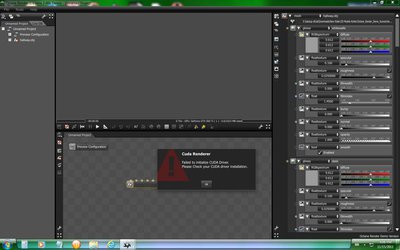

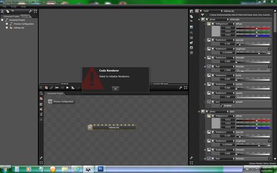

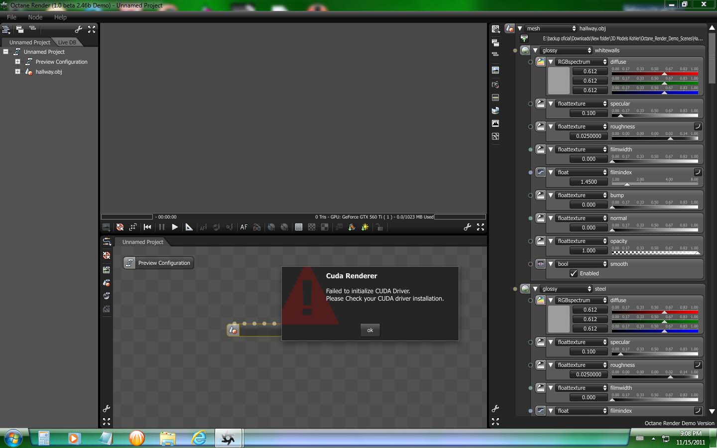

It turns out that here. I'm using the onboard video to the monitor and you Gtx560 for Octane, have already installed the latest driver board, and still the same, this message appears when I try to load a objeto.O wonder what's going on? Please anyone who can help me.
