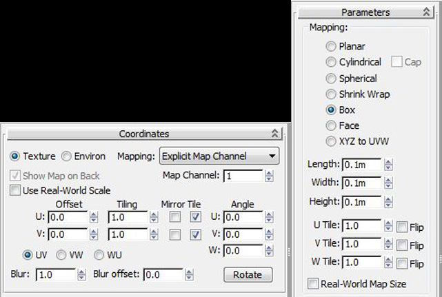

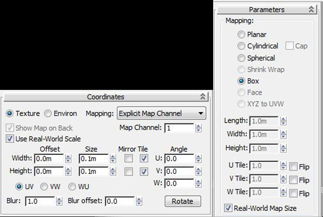

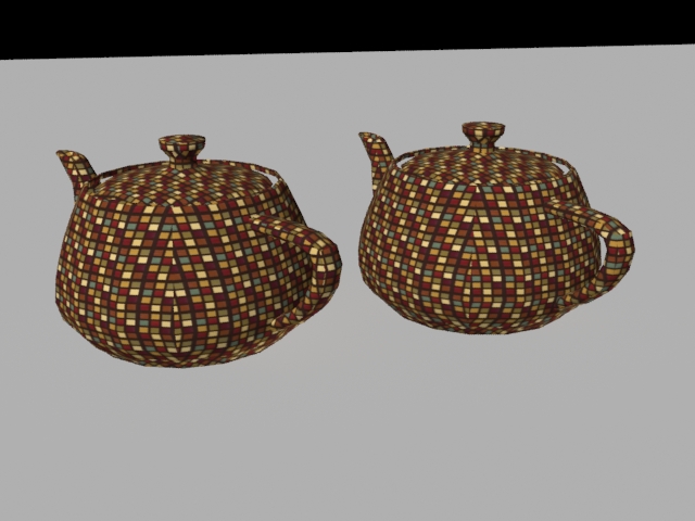

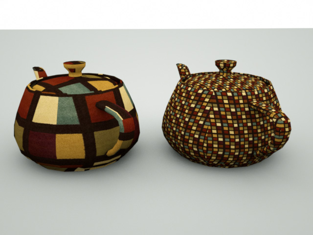

the problem is this that the max exporter does not export maps correctly to octane when using "Real-World map size" option... i will attach pictures of the rendered images in max and octane to compare, also i will attach the uvw map settings of the objects.
Well i can work without the "Real-World map size" option, but i think at least for Archviz its much easier and much faster to work with this option set to "on" also if this option is not implemented for export, i will have to change the scale manually for each object each time... and my material library that took a lot of time to make is not so usefull anymore :(
maybe i am missing something with the configurations... i hope someone can help with this.
thank you very much for your time.
JP
Map settings for LEFT Teapot
Map settings for RIGHT Teapot
rendered with Octane
rendered with MAX
rendered with MAX

I think the tilings are generated over a shader at rendertime.
To check it, take a look in a uveditor. When the result from the teapots look similar, then Max uses a shader to generate the tilings.

I mean, that MentalRay read the Real-World parameter and calculate the mapping at rendertime, although the geometry mapping from both teapots is the same.

i tried with the default scanline renderer and the same thing happens... the problem is that the .obj exporter does not take this "real world scale" option in the calculations...
