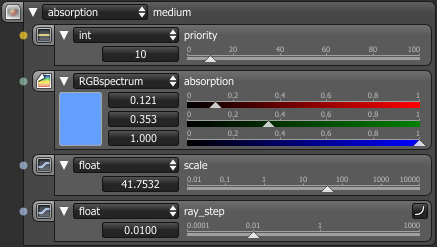

Absorption is controlled with the absorption texture, which defines how fast light is absorbed
while passing through a medium. A setting of 0.0 means no absorption. The higher the value the faster light is absorbed by
the medium. This setting is wavelength-dependent, in the following setup for example it is set to absorb blue light faster
than other colors, giving the object a yellow appearance.
Textures are restricted to values between 0.0 and 1.0, but the absorption value can have a wider range of values. To allow
setting these values the absorption texture is multiplied with the scale parameter.
