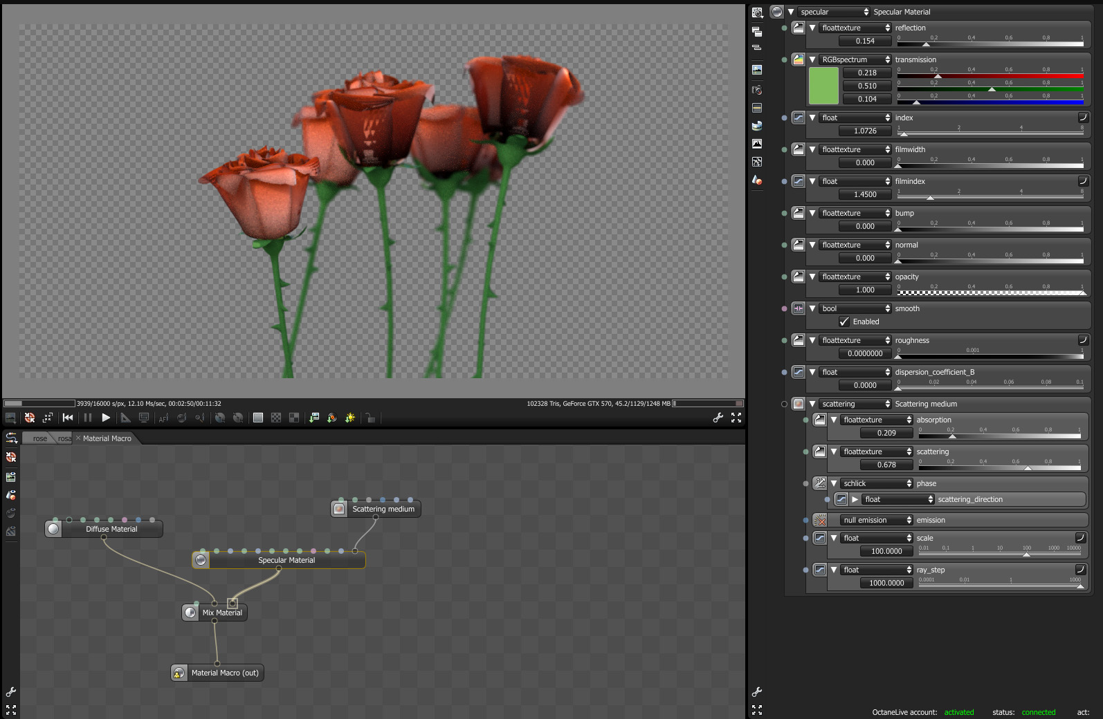

I just did a quick test. Yesterday (or a few hours back) somebody ask about a rose petal material, I had just model one low poly rose for the competition so I did a quick material to show how mixing diffuse with specular with roughness could fake somehow SSS, :lol: well, as soon as I got this release I went back and added scattering medium to that same material macro... and guess what... it looks awesome, and without touching anything. The geometry has flaws so those artefacts are not Octane related but my own fault and you can see them in both tests, the speed is the same, but this is just little peanuts, I'll try later with a more taxing scene. Thanks, thanks and more thanks (dunno what I'll say once we get instances, which might be my most expected feature ever, I'm already out of praise words for you guys)

@kubo: the 2.55 roses are awesome! a little less glossiness and a little more polys and i'll take them for real. thanks for posting these, they are mouth watering - what doesn't mean btw, that i will have roses for lunch :)
