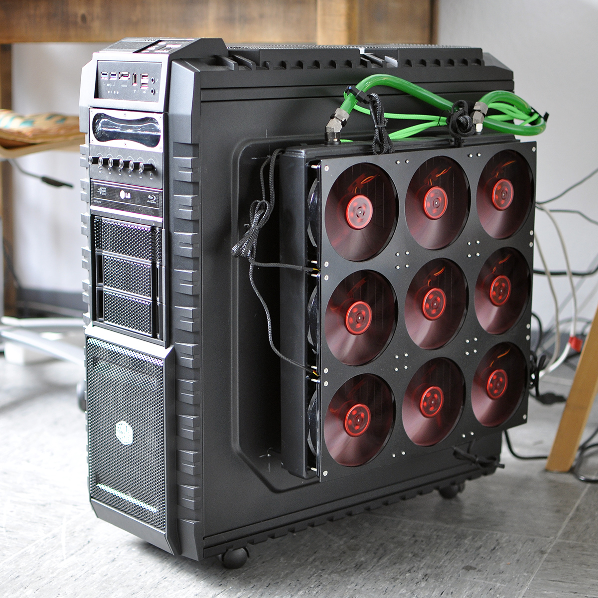

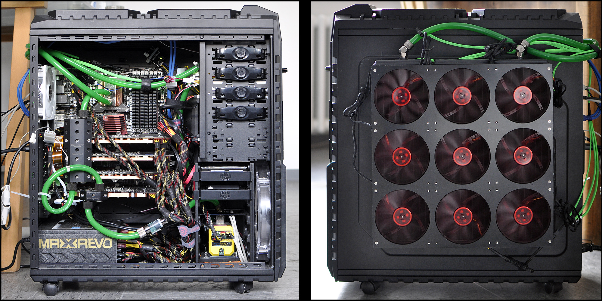

Hi,jitendra wrote:Hey,
Can you please post some pictures?
I am also curious to know which case you used ? The 4th graphics card with double thickness is quiet difficult to fit due to the usb, firewire , and other ports just below the slot.
Jitendra
here are some photos of the Octane Workstation that I have tuned a bit.
HafX Case with 3 GTX 590s plus a GTX 580 (3GB) for larger scenes.
The GTX 580 is below.
The Radiator is outside so there is a good cool airflow inside the case.
The cards don't run hotter then 61 degrees and the sound is still ok even when working under full load.
I was lucky to convince my client to use Octane for the current project. So this is the machine I go with. No renderfarm needed any more
All in one case.
Refracty
