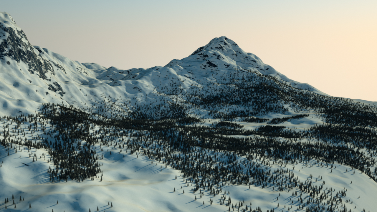

						Trees population test :
I encounter big problems with Blender 2.59 not able to make particles real over around 3000 (My particles are modelled trees. More particles could be converted if simpler). The maximum I have been able to make real is 5000 with medium poly trees in 5 operations on 1000 trees each time (12500 with X-billboards in 10 operations), but I also encounter exportation problems with the obj exporter for 2.59 exporting nothing on some files.
So I had to come back to Blender 2.49b, and I made real 50 000 trees (5x10000) of 258 vertices each with textured branches and trunk, supporting relative close up view !
I exported them in obj in 7min 40s with the exporter for Blender 2.49.
The loading time in Octane is 41 minutes !
Win7x64 ressources monitor displayed 18.443GB... as my system has only 8GB, the 41 minutes are due to constant access to swap file.
The scene weights 2179MB in Octane of 2879MB available on my GPUs, and is composed of 10 120 200 triangles.
