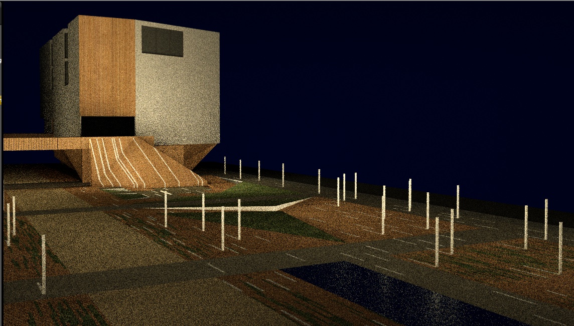

I agree with you a 100%. Unfortunately, I'm already exceeding the amount of things I can do and learn at the moment.
I did, however, find a way around the problem I was experiencing last night, which might help those archicad users that are strictly using it to model and holding off on the application of final textures until they are on the Octane spectrum of the rendering process.
Simply export as a Cinema 4d file. Delete the sun and cameras associated with the archicad environment and use the octane plugin for C4d to export as an .obj file. No UV mapping required. You can just go ahead and start applying textures in Octane.

This might be the crux of this process - but never the less. Make sure that you have a good idea where the direction of materials are going on your object mesh. Make sure that all elements have a specific material assigned to them. So if you have a wall that is angled and whose material needs to bleed into a floor feature - be sure that both elements are assigned different materials (there might be a better way of doing this, this is something that I know how to maneuver through in Artlantis but not in Octane).
