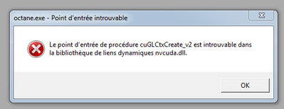

i've a problem running the demo version.
You'll find a jpeg showing the error message below.
(it's a french version off windows)
can anyone help me??
thank you
error message
error message
radiance
Posts: 7633
You need to download and install the latest drivers for your NVIDIA video card from www.nvidia.com

thank you
it works now.
