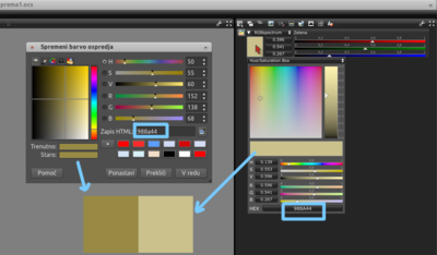

I was doing some material which colors I tried to match from a reference pic. So I opened the pic in GIMP, picked the color and then pasted the HTML code into Octane. There I realized that the color in the Octane picker looks a lot more different (on the same monitor) than in GIMP. As you can see the HTML code (circled in light blue) is the same in both pickers:
So, yeah, I'm interested too how Octane treats colors and which would be the right workflow? In GIMP I have the default monitor color profile, but Octane doesn't support color profiles. Is that why there is such difference in the apparent color?

Wow, that's interesting... hmm. I wonder if Octane gamma corrects the color picker or not. In max, there's an option to show gamma correction in color picker and materials. As far as I know, there's no similar option in Octane. I'm not sure how to explain the disparity.Anyone?

@hadouken, I think you are right about gamma. If I gamma correct the color from GIMP (the one that is more dark) with 2.2 (default Octane gamma) I get the same washed out color as in Octane. And if I gamma correct the color I picked in GIMP with 1/2.2, then past it's HTML code to Octane I get the right color that matches the original reference.
The question now is; does this input gamma correction happens also with textures? If someone would clearly explain things around the color workflow with Octane, it would be great.
Also, about the original question; The tonemapper applies only to output not to input, it seems, so there's no way to change how Octane treats input?

The inputs of the color picker, including the HEX input are linear. So it is unfortunately not very useful for web colors (which are normally given in sRGB space). We will look at how to resolve this issue.

Thanks for the clarification.
If we could eventually have the option to use a linear or gamma corrected picker in Octane, it would be great. For example all the graphical applications I use, have gamma corrected picker, so a color of (0.5, 0, 0) is consistent among them, except in Octane where is brighter.
