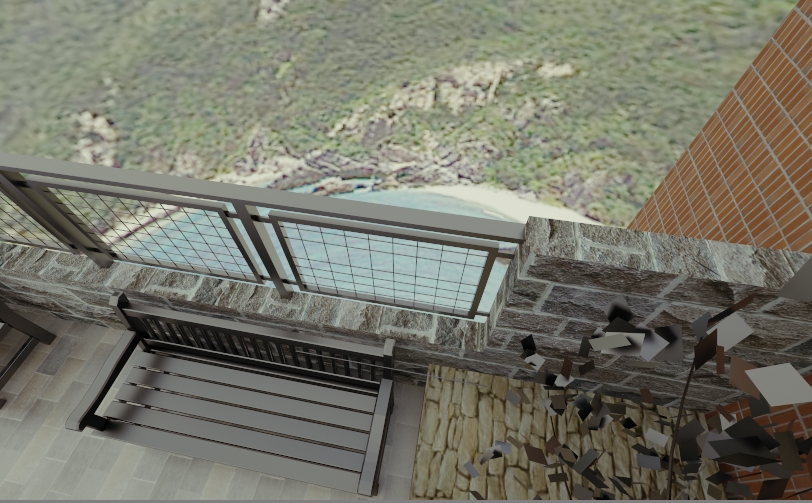

I am managing to get the sketchup materials into octane now, i just need to work on some minor issues
comments welcome
The balcony view
Wow that building must be reaaaally high
Good render but some textures are not that good
The tiles on the floor look too tiny versus the rock wall
Also a balcony with that type of rock wall is strange
The top texture of the balcony wall is the same than the side, look strange maybe rotate the top UV
And the texture at the bottom of the tree could be some fine gravel instead of those yellowish rocks
If I look for 2min at the render, I start to notice that the scale is wrong.
Textures wise but also geometry wise, the bench look really tiny I think
That's it for my comment

thanks for comments sam i did the drawing in sketchup to scale then reduced it so that i could import in to blender
the model in blender was half the length of the grid square in blender i am still try ing to figure out scaling in blender any suggestions with scaling for octane

sketchup output in feet
octane in meters
Problem solved, I use that and it works fine.
