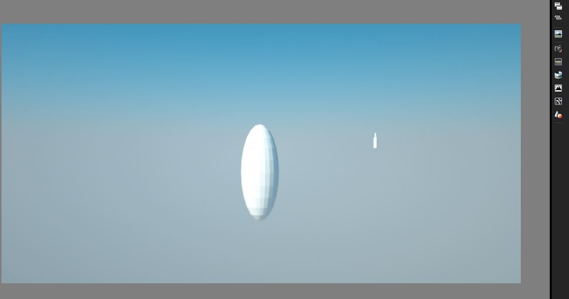

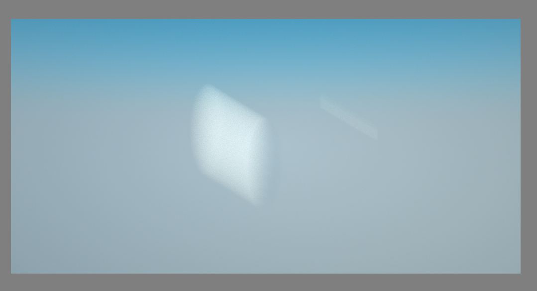

Just on a scene, - a simple sphere deformed - it's a very strange issue: the first display is ok but as soon as i rotate the octane camera, there is like a motion blur effect ( :shock: !!) and impossible to refresh the good display ( still this blur each time rotating...).I loaded some older scenes and it does not happens, it's very strange... Perhaps it is the annoucment of the motion blur for the next release :D
( look at attached picts, i join the zipped scene too, but the problem happens only when you launch rendering with lightwave, if you directly load the OCS film, it works... )
Working with lightwave 10.1, exporter v0.3, win7 64, 2 x GTX470 nvidia v280.26 whql
I tried some other scenes with maya 6.0 and no problem...
