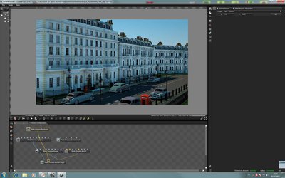

Hello, I really think that there is something wrong with the Relinking feature, or it is due to the way memory (RAM or VRAM) is managed.
If you look at the proof screen below, you will see that the scene contains almost 10 millions of triangles, is rendered in 8192x4608 and that there is still some space in the VRAM.
I can move in the scene and edit materials.
However, even if I have a scene with "only" 8 million triangles (I remove one building), I can't relink it (I get a crash at the end), except if the file is exactly the same (no interest).
So, as I asked in an other topic, I'd really need to know if the relinking process loads in RAM and/or VRAM at the same time the previous and the new scene, requiring by the fact more memory space.
It could explain that I can't finish to setup the materials in the current scene and have to redo everything from scratch with the new obj instead of just relinking the last modified obj and keeping all adjusted materials...
