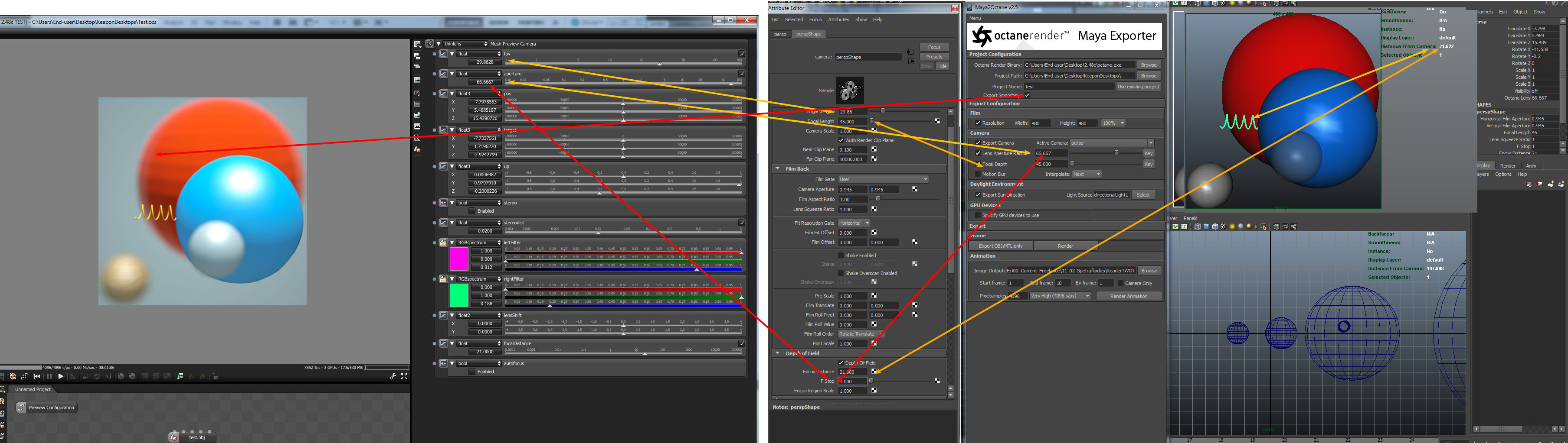

I was trying to figure out which settings in Maya's Camera and which settings in the plug-in and where they were in the Camera in Octane.
Think I got most of them... am I right on assuming that the f-stop on the Maya Camera has nothing to with depth of field in Octane?
Also I notice that when you increase Lens Aperture Radius a higher number gives you more blur.... when on a camera a higher f-stop gives you less blurr on depth of filed. Not a big deal, just counter intuitive to normal lens understanding.

May help with Camera Settings

hi p3taoctane my friend,
i was away for a while, work work work
ill get the latest ver of octane and see if there is a probl with exporter, but as far as i know exporter doesnt export any value from depth of field
i hope i got it right, i mean the probl u talking about...
cheers
cheers
