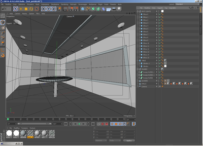

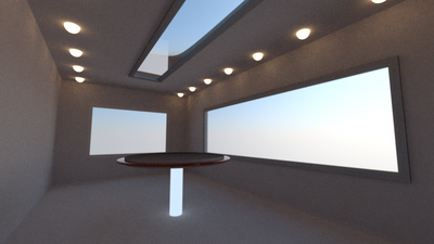

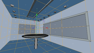

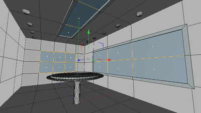

Hi Octaneer, I just did my first test of an interior scene, a very basic scene I know. I followed all the suggestions of the Boss. I'm very happy of this result so I want to share my setup, step by step, just to clear any doubt about occlusions between portals and windows.
So.. you can see the attached images... first of all you have to create the walls and then to select the polys that will be the portals (don't cancel or separate them from the walls). Apply 2 different materials, one for the walls and one for the portals (you have to modify this material, inside Octane, by changing diffuse to portal). Further more you can add the glass geometry by selecting the edge loops all around the portals and then you have to create a spline from the edge with the appropriate command. So you can use this spline to create the glass mesh and the frame sweep. Finally apply a new glass material. You will obtain an interference from windows and portals but this is ok... when importing into Octane you will see all black, so just change the glass material from diffuse to specular and change the index to 1.01, change transmission to white or light blue and add some reflection. That's all. I hope you will enjoy it... and sorry for my bad english.
