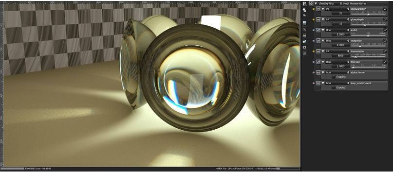

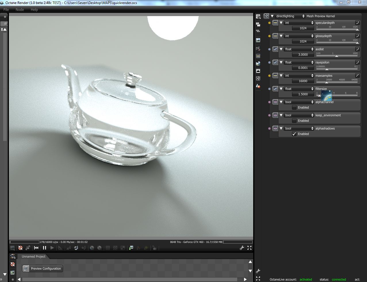

I do not understand why the caustic does not work in direct light ...Оо
48s do not
48s do not
in 47 it worked
in 47 it worked
abstrax
Posts: 5516
Elvissuperstar007 wrote:I do not understand why the caustic does not work in direct light ...Оо
Because the direct lighting kernel only traces direct light. Caustics are indirect light and for those you need either the path tracing or the PMC kernel.
