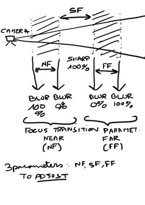

i think the goal is not to reproduce the real cameras ( with all his optical constraints-> i do 'real' photographs for my job...) but just to define right parameters without confusion but flexibility:
Please look at the pdf attached: it would be nice to have such parameters fort controling the 'deepness" of DOF. Do you think it would be possible ? It will be a great help for creating virtual photos with octane
. Just this kind of settings should be in conflict with actual aperture/focaldepth parameters... perhaps it should be a solution...
There are many factors that affect depth of field. The most important are the focal length, the distance of the subject and the camera's aperture setting.
Now...in octane the only value that changes the DOF is "aperture" setting. this is not correct ok?
You can make sure that the depth of field is managed as a real reflex? (like Maxwell render).
