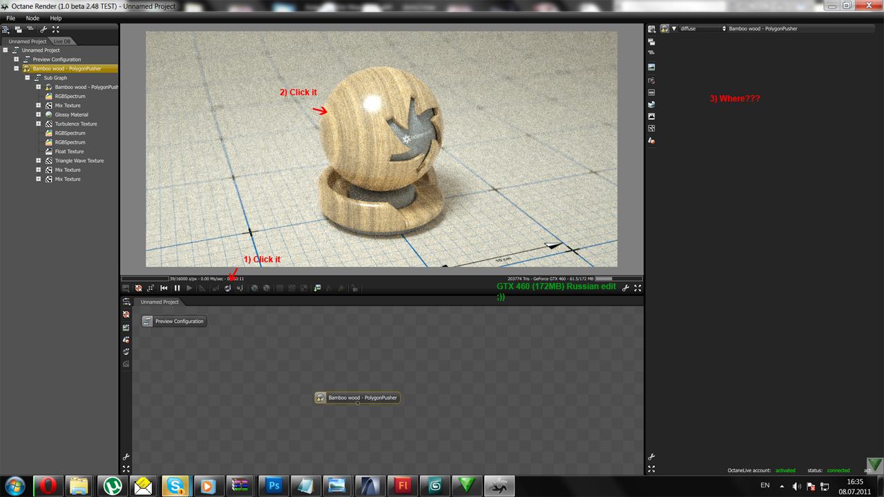

Elvissuperstar007 wrote:very bad release ......................
not stable
material properties do not appear !...... Old glitch
PMС slow
what a portal?
Could you please be a bit more specific? What do you mean with "not stable" and "material properties do not appear"? PMC is not slower than in beta 2.47 and as wrote above, we haven't had time to do much performance work on the PMC kernel.
A portal is geometry that guides sampling of the environment light. You place it usually in windows to help sampling light in closed rooms.
Cheers,
Marcus
