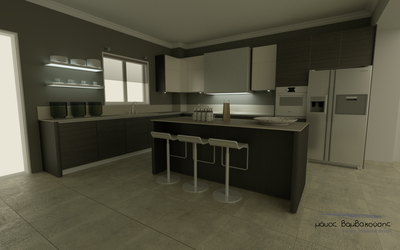

Hello. I need your opinion about this rendering.
Thanks.
new kitchen project
Ok my recommandations
-It looks to dark, put some ceilling light in.
-Make the chrome-materials more look like chrome. More reflection. Make other materials more reflective as well.
-The picture needs more sharpness (aperture value of the camera set to zero or postproduction).
-Shift verticals.
-Generally more live: Maybe some plants or herbes ?
-Try to make it more juicy: All colors are in brown or grayscale and dark. It needs more friendly/ warm/ bright colors.
Kind regards
Alain
-Shift verticals.
Kind regards
Alain

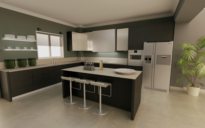

Better
The chrome-material still does not look like chrome. It looks to flat and not enough reflective.
Do you use Octanes Daylightsystem ?
Where did you get this plant from ?
Kind regards
Alain
Kind regards
Alain
Intel Pentium 2.8 GHz 2 Cores, 8 GB RAM, GeForce GTX Titan 8GB, Blender 2.72b, Win 7 64 Bit
Just a simple texture environment light and emitter light on the celling, the plant is ready 3d model from http://archive3d.net/
