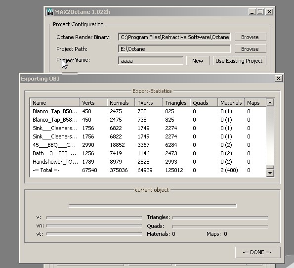

The specific problem I am struggling with is how to deal with separating materials when importing to Max from Revit.
I have attached a screenshot of the output when I run the Octane obj creator. Whilst there are around 400 materials , figure in brackets, which have come across from revit to max, only 2 of those are being exported to the obj file. The only way I have found around this at the moment is to manually assign max materials to each of the object which will form part of the final render. Once Max materials have been assigned, the export is as expected. It is, a total PITA to have to assign materials three times. Once in Revit - then Max - Then Octane for the final tweaks.
Does anyone know of any easy (automated?) way of assigning max materials whilst maintaining the material name or of merging materials from revit into max material database?

Hi!
Revit Material Export to Max really is a tricky matter - I've been working on this for quite some time now. I guees the only way to is to use the fbx-interface from Revit to Max to get a maxfile with multichanneled material applied on your geometry. However, fbx-files from Revit are really hard to modify, since all material information is to be found in the different subchannels.
I'm working on a script to fix this matter, including some other optimization tools for the Revit-Max-connection. Stay tuned on scriptspot.com!
