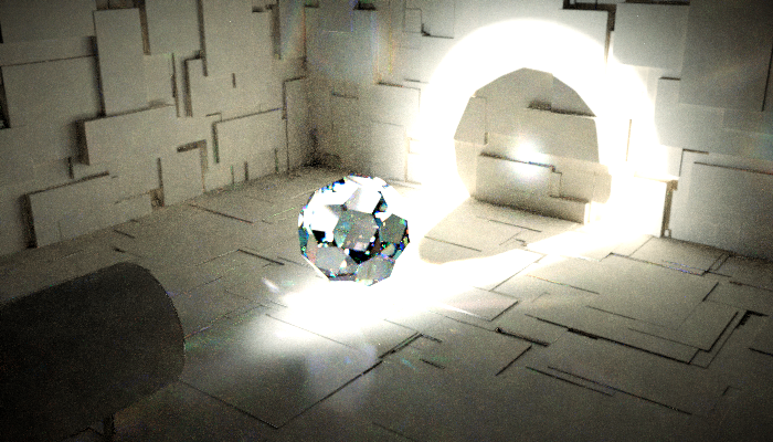

here is a test i am doing with the new pmc kernel. and i'd like to know how i can create something like a parallel light source?? i have now created a long tube where i have placed a plane as a lightsource. however, it still creates something like a spot light. how can i create a laser light??

the reason you're not getting the desired result with your tube ello, is that your plane light is bouncing off of the inside of your tube.
the closest thing you'll get to a narrow beam of light is using ies lights. there's free ies generators out there that let you create your own ies files - in case you can't find one that's narrow enough for you.
not exactly an answer to your question in know, but still somewhat helpful i hope.

thanks to both of you. bouncing shouldn't be there since i have an inner tube with diffuse material and color of "0 0 0"...
i'll try using an ies light, this sounds like a good idea

just do a longer cannon to narrow the diameter of the spotlight

Three, different length cannons and the beams they produce. I'm doing a render of these same beams with some obstacles... post or edit later...
the diameter of the beam is determined by the cannon's diameter. Make it very narrow and long, like a 1:10 ratio between diameter/length; The cannon interior is bouncing nothing because its a diffuse black material.
