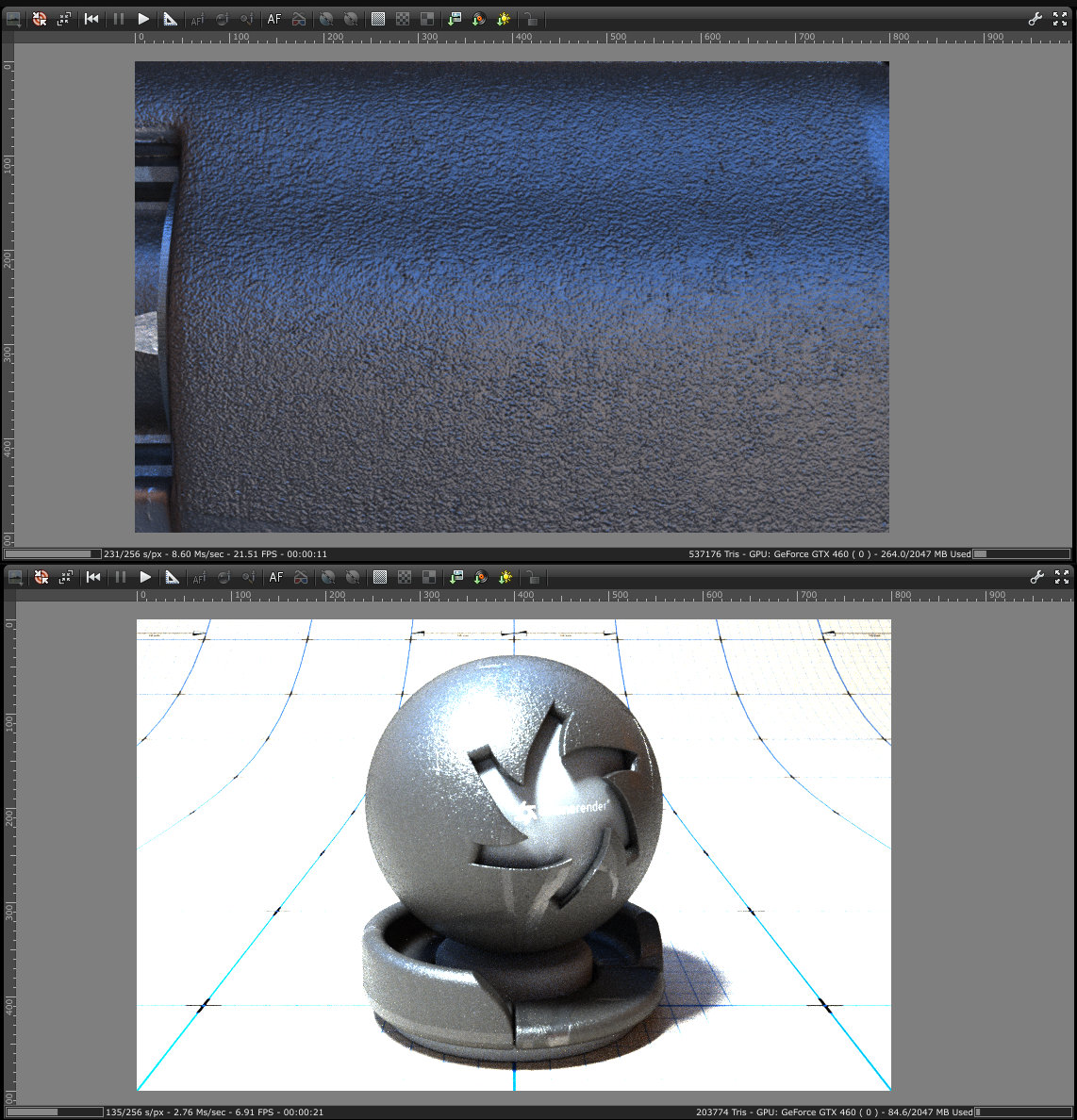

First of all, something that was introduced (or it's power has been raised?) in the latest build(s) - the "camera light" when you are on the preview scene. On the same lighting and imager settings that light burns out the preview scene, forcing you to re-set exposure every time you jump back & forth between your actual scene and the preview one. Compare this same material on the same lighting & imager settings. The top is the actual object.
The preview scene is burned out because of that light. Tunning down the exposure doesn't really help, because you can choose between an over bright light spot on the mat. or a dark surrounding. This "preview light" is bad IMO, and we should at least have the option to disable it or control it's power.
