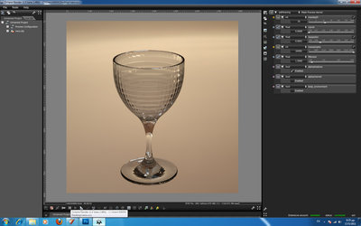

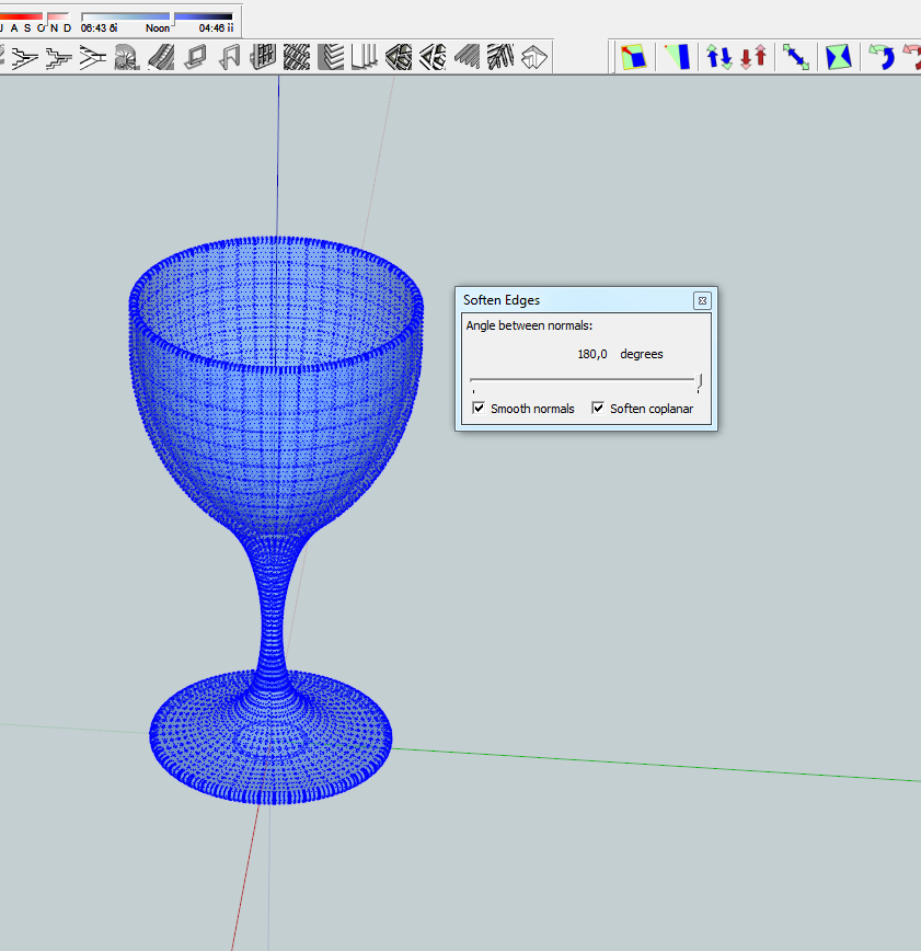

Hello, does any one knows why i get all this planes when i render, even when i smooth ?

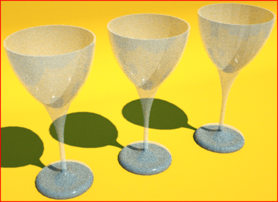

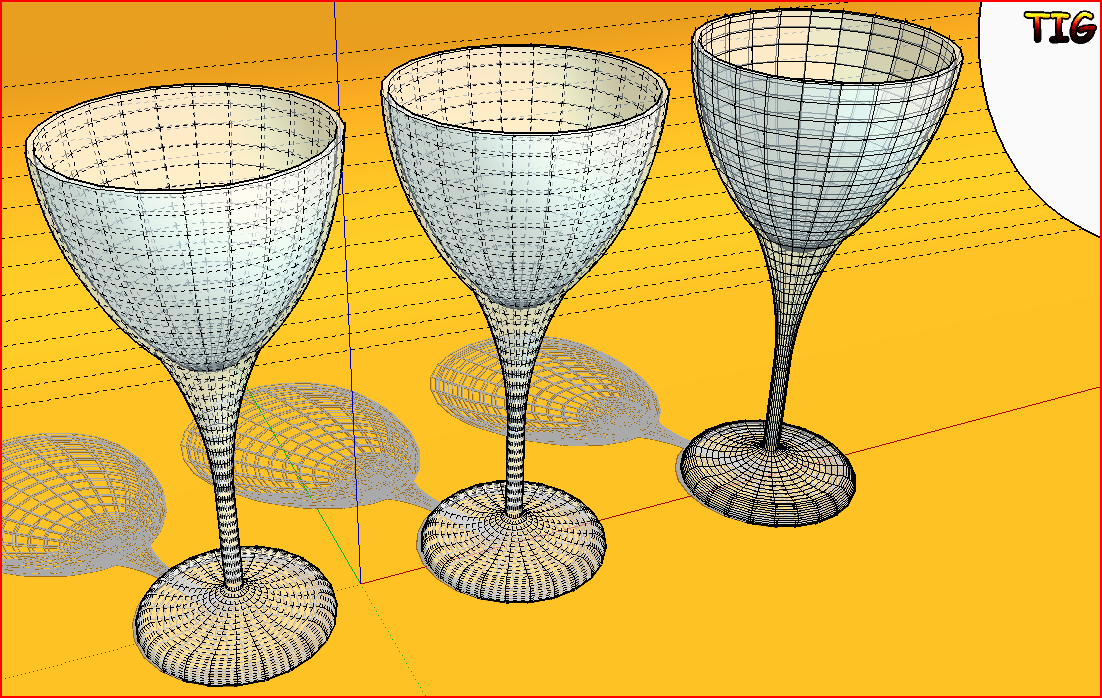

Here's a quick Octane Render I did of this SKP with [from left to right] smoothed, smoothed but reversed faces, NOT-smoothed [you can see the faceting ]. The latest versions of the Exporter work fine
[there was a problem with the initial release which was ignoring smoothing etc but that's been fixed for a while]

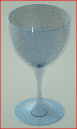

This was rendered from your unchanged SKP to a new OCS with the settings shown, using the latest Exporter tool = NO faceting :?
