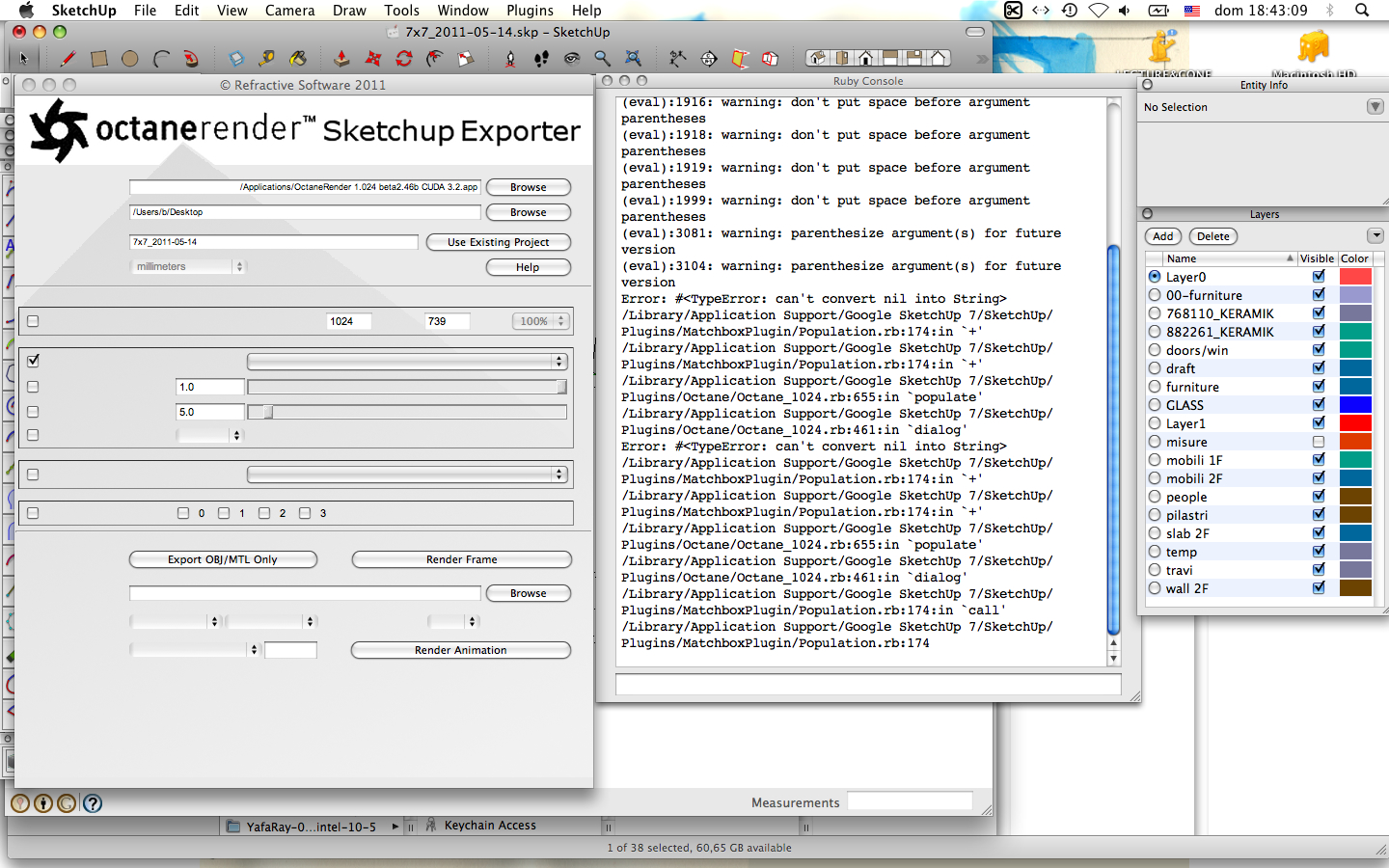

Hi, ;)
I put all files of the exporter correctly as per readme instructions.
I get the exporter dialog window with no text (see images), ruby console message is attached too.
All files of the exporter are in the right position so I don`t know what could be wrong. :?:
Mac OS 10.5.8
Language for menus etc...is set in English, SU7 is an English download too so it should not be a problem of language incompatibility.
Any hint?
Many thanks in advance for your help.
MacBook Pro, Intel Core 2 Duo 2.53 GHz, L2 Cache 6 MB, DDR3 4 GB, NVIDIA GeForce 9400M

Could you retry and post the entire Ruby Console error messages as text as what you show misses lots out...
For some reason it makes references to 'Matchbox' which is someone else's script with no connection to the the Octane Exporter at all ??
Can you try removing the 'MatchboxPlugin.rb' from your Plugins folder to prevent it loading other files from its subfolder... and retry the Octane Exporter, in case it's a clash of code... MatchBox has been earmarked as a script to be avoided... because it arbitrarily changes built-in classes like Ruby Array, and therefore causes crashes with other scripts... so I suspect this might be the culprit this case too... I suggest you try removing the loader script as explained above :roll:
It's also weirdly reporting an error loading a file called Population.rb in the MatchBox subfolder - which is weird as it's not a file supplied in Matchbox ??? or in the Exporter either ????
Note, if you have opened any of these .rb files to read them with a wordprocessor rather than a plain-text editor, and then saved them, they could also have been 'corrupted' ? Re-download and replace ??
TIG

Postby gozilla » Sun May 15, 2011 10:56 pm
gozilla Sun May 15, 2011 10:56 pm
Thank you for your fast reply!
Matchbox erased.
I also put some order in my plugin folder.
No error messages and the Ruby Console message is shorter but still text won`t appear on the exporter window.
Any hint?
Thanks so much for looking into this!

Postby TIG » Mon May 16, 2011 9:26 am
TIG Mon May 16, 2011 9:26 am
gozilla
:? The error messages you get in the console do not have a 'culprit' listed like most but the 'line numbers' listed bear no resemblance to the Octane.rb code as most of those lines are ### rem code and have no arguments to parenthesize or correct the spacings of... It appears that there's another script in your set causing this ?
I assume you have now disabled all of the 'Matchbox' files ??
As well as 'Matchbox' there was a script called 'Train-Simulator' also implicated in such things... if you have it then retry after disabling that...
Incidentally, have you only just started getting these errors with this version? What happens with earlier versions??
You do have deBabalizer.rb properly installed and lingvo files in the Octane folder??
If all else fails we can try running a bare-bones Plugins set and slowly add to it until we find the cause of the issue...
