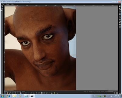

thank u radiance so much for the info and tips im gonna try it
and about the model its dazstudio ready model i just export it from poser to obj for octane SO I played with MATERIAL maps BUMP SPEC ETC. MY GOAL WAS TO FIND OUT WAT is THE BEST tweak for skin material in octane to achieve ultra realistic charactar looking .thanx to octane it did the job even without sss when i saw the resaults

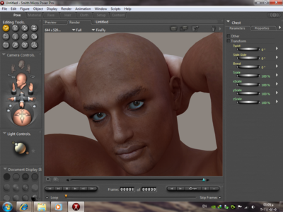

octane rocks. here is the same model renderd on poser setting maxed with gi
