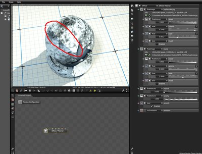

This problem was not resolved in new version of octane( 1.0 beta 2.46)?
Sharp transition zone between the light and shadow.
This problem is not visible only whit out bump image...if i use only image on diffuse channel.

That is a result of the bump strength that is way too high. Reduce the bump strength and it will look ok again.

That ok but the result is not the same ......maybe for a result too strong i have to try the normal map...
