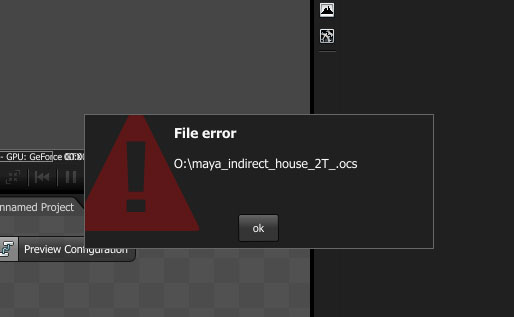

i did a mistake, it's not about the 'obj' but the ocs file ( look at the lower picture attached to this post ).
So when it happens ( always after the 2nd or generally 3th frame of rendering, with the 2.45 or 2.46b versions of octane, but no problem with 2.44 version ), the animation rendering process stops ( of course ;) ) and if i launch a manual rendering with the same session ( just after the error message): it works !..

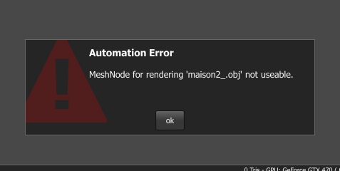

when i want to generate a new ocs file from octane( same scene but with a new name, for new texturing or rendering settings ), and when i choose, with maya exporter, this new setting file ( ie 'maison2_.ocs' like the picture attached ), it doesnt work ( look at the upperpicture attached to this post error message with 'maison2_.ocs' -> meshnode not useable ): but if i launch a manual rendering process of 'maison2_.ocs' directly after this error message, it works ( with the new settings ):
can you explain me why ? ( (i tried with many different files, always this problem even with the 2.44 version ( and 2.45 & 246b too) )

Just for your information: You get the automation error, if the exporter tries to select a mesh node that doesn't exist. In your case it tries to select a mesh node maison2_.obj. I guess, you originally exported the scene with the project name maison2.ocs and then renamed the OCS file to maison2_.ocs, while the mesh node is still called maison2.obj.
