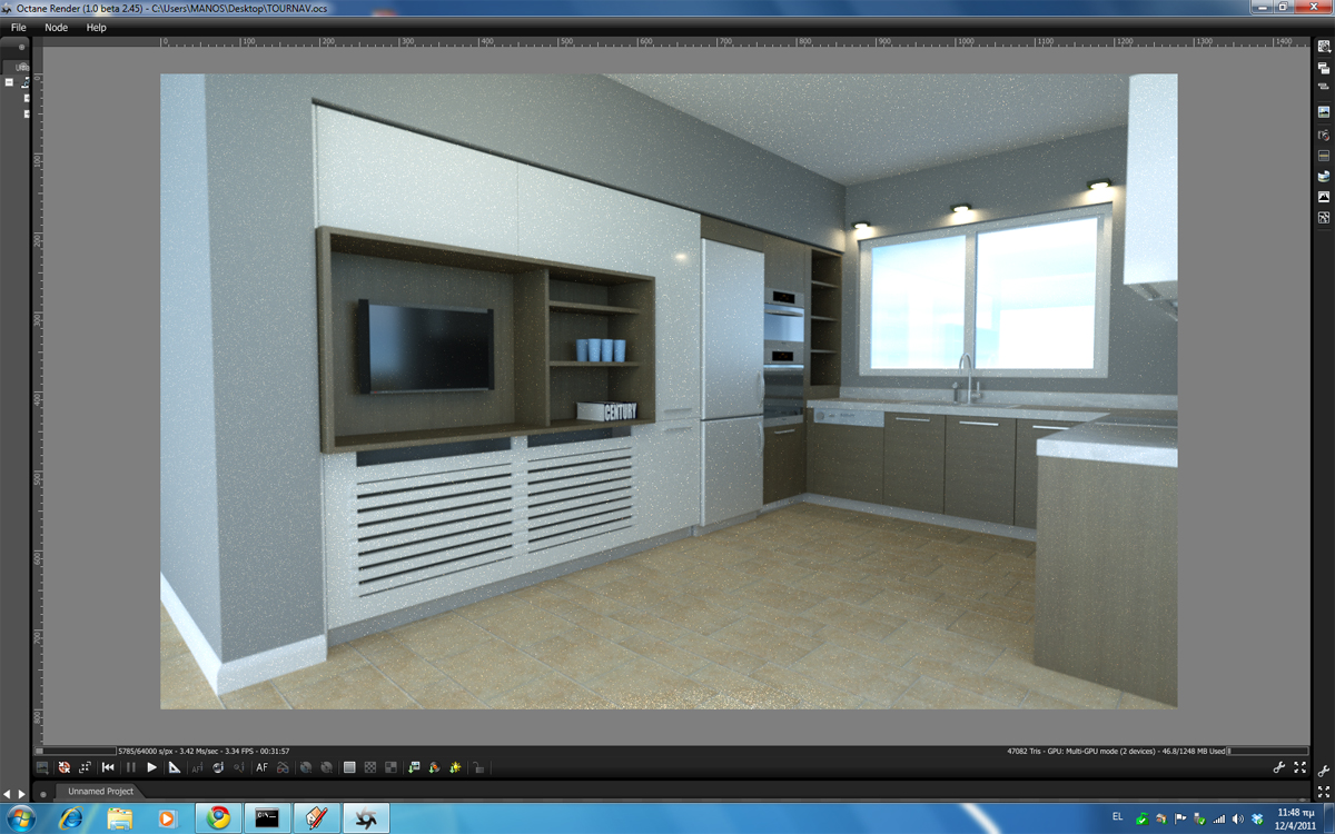

Hello everyone, i'm trying to render with octane but it seams that i can figure out the right configurations for realistic resaults.
If enyone wants to try you can donwload the folder with all needed files (obj. mtl. ocs and texture folder) from this dropbox link.
http://dl.dropbox.com/u/7864808/render%20this.rar
this is what i did.
I'm not happy (the images are not very sharp not very clear and realistic)
Can you give me any sugestions about lights and enviromet light.
Please post back the scenes configurations (pathtrasing, maxsamples, rendering time , and specially how you light the scene)
Thanks in advance.

The Translucent window doesn't add much to the scene in fact I think it ruins it myself.
I removed your hdr image and used the basic texture light and used ies lights above the sink scaled so they don't produce much light on anything but the immediate area. This combination made fireflys all but none existant.
