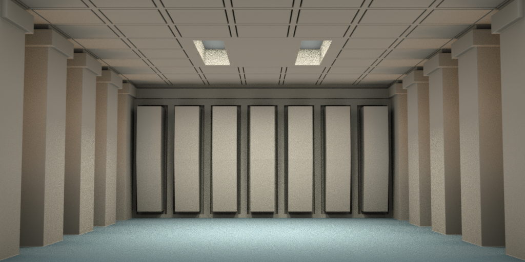

hi, i think there is something wrong between the actual light that an object emits and the brightness of the surface. look at the image attached. the ceiling lights emit quite much (efficiency set to 1) and power near the max.. but the mesh itself is too dark
any idea?

I have seen this too, but if you fiddle with the float image scale you will see the bright stripe of the image (or .ies) come into place, just like it would if it were a texture bitmap being scaled onto the surface

ello wrote:hi, i think there is something wrong between the actual light that an object emits and the brightness of the surface. look at the image attached. the ceiling lights emit quite much (efficiency set to 1) and power near the max.. but the mesh itself is too dark
any idea?
cheers,
ello
Are you using a distribution texture? If you do, the brightness of the emitter is dependent on the viewing angle.
