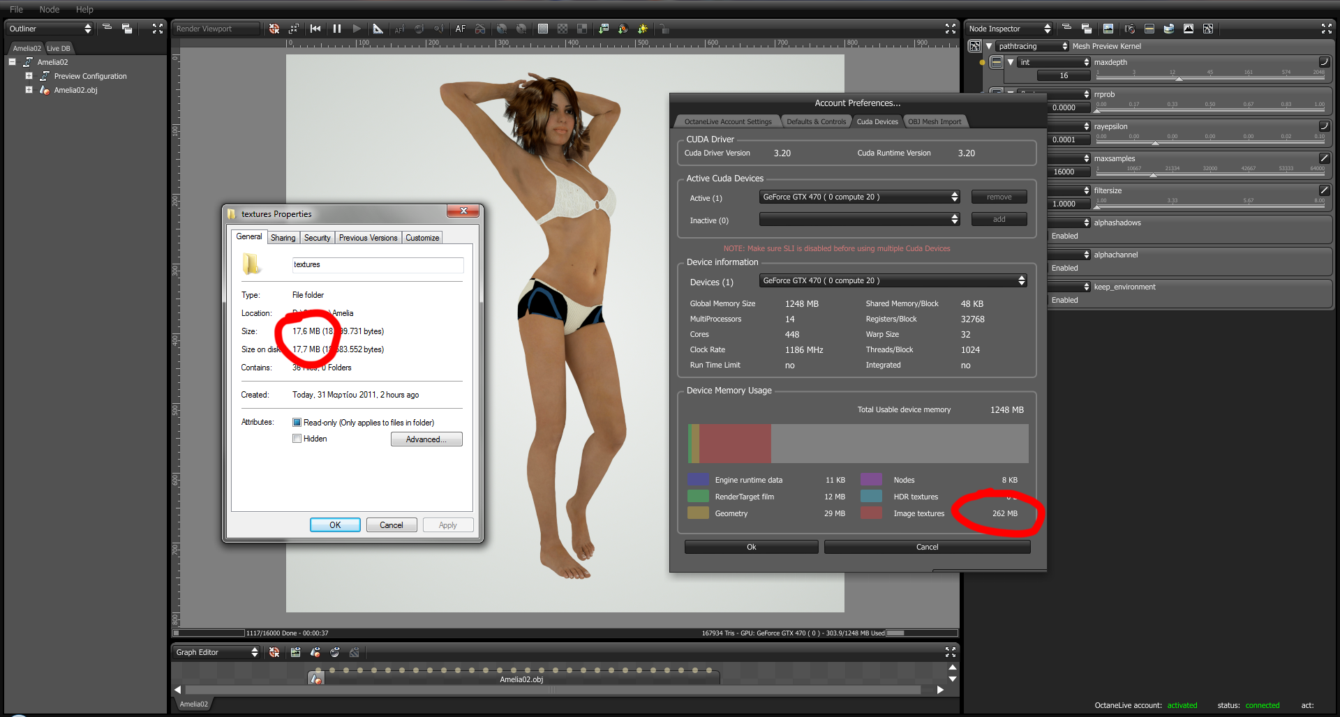

Hi, I would like to know why a small file of texture becomes a huge amount of MB??
See the two red circles in the image bellow.
Thanks in advance

Most textures are stored compressed on disk, but they are then uncompressed when loaded into memory.

Ok I see, so octane is decompressing the image file, but is there a work around in order to keep it compressed so the amount of render file low?

Textures have to be stored uncompressed while rendering, but you can reduce the amount of memory used, but reducing the texture size (i.e. width and height in pixels).

Ok thanks for the reply. For the record those images are already redused from 4000x4000 pix to 1500x1500 pix. A quick thought is octane to use compressed images in order to handle more complex senarios because I had to import 4 characters with the same amount of tex ram in a heavy scene...Keep the good work guys!

As I also encountered memory limitations, I studied the thing a little in depth, and my advice would be TO NOT USE JPG images !
First, I thought that using compressed images would save some memory. In fact, it is often the opposite !
The reason is that when the original image contains few differences in a certain color, compression leads to create artifacts and pixellation in areas where the color is changing. This means that compression can generate more different colors than existing colors in the original image.
When the image is uncompressed by Octane, the image weight can be superior to the original uncompressed image ! So, I would rather advice you to use bmp images if you don't need transparency, or PNG or TGA images if an alpha layer is required. These formats are almost lossless, and generate no or few artifacts.
If you original texture is a JPG image coming from a digital camera or a JPG texture found anywhere, I would advice you to convert it in bmp before any modification, and keep it in that format or save it in PNG or TGA if you added a transparency in your image editing software.
As each compression adds new artifacts, if you save an image in jpg after working on it, the uncompressed image will be bigger after each new compression !
