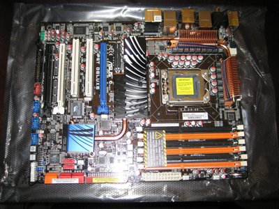

Hi i order octane render last night i have followed it for a while and now its time to make some changes in my workflow and i think it will suite me well.
Iam going to spend like 1200 euro on new graphic cards,, today i have a geforce 275 gtx
So my questions is because iam not the best man on computer tek.
I have three pci express ports on my motherboard i have never used more than one card so where should i install them?
(i have upload pic of my motherboard.)
Is there something that i should think of ?
/DIA

A card that uses x16 can be put into x8 for example, it just slows down the speed of the card slightly, which in this case as a display card won't make a bit of difference to you.
So your setup would be:
A motherboard with 2 PCIe lanes.
Nvidia 210 • With monitor plugged in.
Gtx 460 • Nothing plugged in.
A good brand power supply with 2 PCIe Connectors at around the 500-600w area. (2 for GTX460, 210 doesn't require any)
In Octane's options you'd just set the 460 as the only card to use leaving the 210 displaying everything nice and smooth 8-)
Odeas
Posts: 49
Joined: Fri Apr 23, 2010 2:28 pm
Location: Manchester, UK
Dia the 3 white PCI lanes are all 16x capable although you'll only get 2 double width cards in there (GTX4xx or 5xx series for example).
Unless you can find 3 super fast single slot cards then really your looking for 2 cards (one in the bottom slot, one in the top - the middle one is covered by the bottom card!).
2x GTX 590's are going to be the fastest setup at the moment.
They'll say they're 3GB but they are in fact 2x 1.5GB modules so you'll be be limited to 1.5GB of RAM for Octane.
For a larger memory you'd want 2x 3GB 580's, which would give you 3GB of ram however this is a slower solution.
GTX590 is 1024 Cuda Cores (as its infact 2x GTX580's on one card with slightly lowered frequencies)
GTX580 is 512 Cuda Cores.
If you can keep your scenes within a 1.5GB limit then 590's are your choice.
If you can't then your gonna have to go for 580's.

Thanks man :) Well i need the memory so it will be two 580 then :).
Really appreciating your help .
