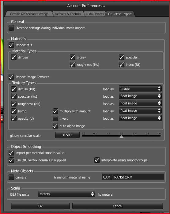

Here is also a screenshot of MY settings that work in case someone else has other settings that don't :?

There were some changes to how smoothed edges are processed in the new version [to avoid a rare 'flipped face' glitch], BUT nothing that should ultimately change the OBJ file's contents - indeed if you trawl through two OBJ files made with the two versions of the exporter every line looks identical to me ??? Also they ALL smooth properly for me anyway... Which suggests it's maybe an Options setting in Octane itself for your particular setup ? :roll:

can you test your smoothing with the default octane OBJ import settings ?
These are:
- import per material smooth value = ON
- use OBJ vertex normals if supplied = ON
- interpolate using smoothgroups = OFF
I think the issue is that if you enable the last parameter (interpolate using smoothgroups),
octane will simply recompute the vertex normals based on groups/edges and you don't end up using propper supplied vertex normals from sketchup.
As all users have these settings by default, it's important that the exporter writes out vertex normals propperly so that it works like all the other exporters,
otherwise users will end up with several problems, for example you will lose control of normal direction which can cause artifacts in renders with transmissive materials like glass...
