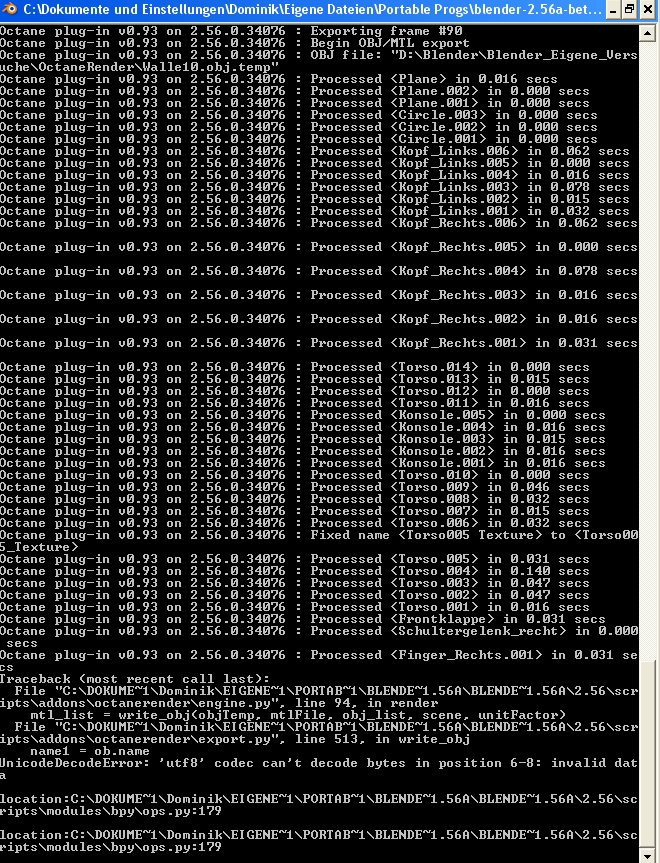

Hey guys,
i recreated Pixars Wall E a while ago in Blender (Here's my Blender render animation http://vimeo.com/16227737)
Now i wanted to render this little guy in Blender but i always get the message "Something wrong happened, please check console logs"
I can't figure out what it does all mean?! Maybe one of you guys could help me?! :cry:
Hardware: Nvidia GTS 450, core 2 quad q6600, 8 GB Ram
Software: Win 7 64, Blender 2.65, OctaneV1.0 RC3
matej
Posts: 2083
Joined: Fri Jun 25, 2010 7:54 pm
Location: Slovenia
It's better not to use any non-ASCII characters in object names, image filenames... anywhere, to be on the safe side.
