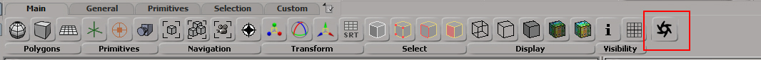

Hi face,
I've a little question for you.. :)
Can u create a button to facilitate the opening of the PPG Octane's without going every time to the file> export .... etc?

Have made a custom copy of the toolbar "Main Shelf".
The files and folders in the zip comes to your...
C:\Users\USERNAME\Autodesk\Softimage_WhatEver\Application\toolbars
...folder.
Toolbar.zip
(4.37 KiB) Downloaded 456 times
If you have a modyfied toolbar or you want to place the button on an other toolbar, you must do some things.
  • Extract only the bitmaps folder/file from the zip to the folder above.
  • Rightclick on the toolbar where you want the button and choose "Customize Toolbar"
  • Select in the new window the group "Toolbar Widges".
  • Drag and drop the "Script Button" to the right place.
  • In the "Customize Button" window, change the "User Button Size" from width and height to 36.
  • In the "Button Label" and the "Tooltip" you can write what you want.
  • Change the "Bitmap" to "OctaneLogo" without the brackets.
  • Change the "Script Language" to VBScript.
  • Copy and paste the following code in the "Script Commands" window.
    Code: Select all
    exists = false
    set oProps = ActiveProject.ActiveScene.Root.Properties
    for each oProp in oProps
    	if oProp.Name = "Octane_exporter" then exists = true
    next
    if exists then
    	inspect
    else
    	gen
    end if
    function inspect
    	InspectObj "Octane_exporter"
    end function
    function gen
    	SIAddProp "Octane_exporter", "Scene_Root", siDefaultPropagation, "Octane_exporter"
    	inspect
    end function
  • Press OK
  • The button is now in the toolbar, but the position isn´t where you want.
    You can now simple drag the button to the right position.
  • After that, close all windows.
  • Choose Yes to save the changes in the toolbar.
Hope that works ;)
Have fun...

Yeahh !! Really easy to install!
I've tried second option!
Tnx face!
