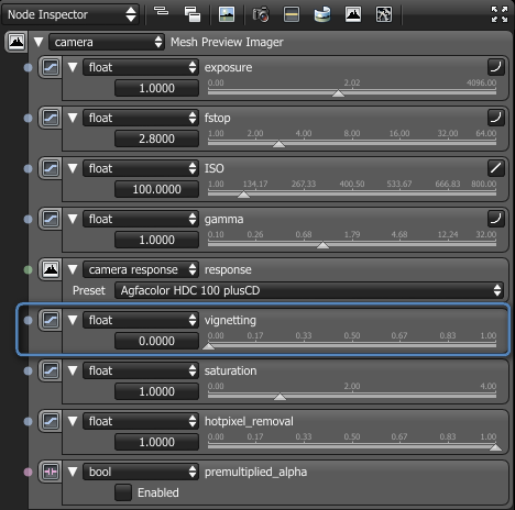

The first step is to prepare your scene for rendering in Octane, as usual. There is only one important thing you have to take care of: Set vignetting to 0 - otherwise your final image will have "nice" grid-like "shadows":

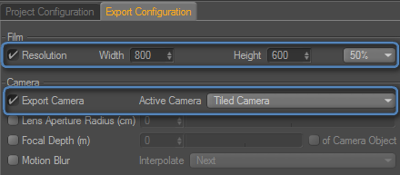

In the export configuration of the export plugin enable the camera export and choose the tiled camera. And setup the render resolution you want, but remember that the resolution of the final images will be 2/3/4/5 times higher, depending on the tile factor:

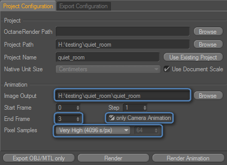

To render the tiles we use the animation rendering. To do that, switch to the project configuration of the export plugin and specify the name of the output images, the pixel samples (== quality) you want to render for each tile, enable camera animation as we only have to change the camera settings between two frames and specify a range of 0 ... 3/8/15/24 (depending on the amount of tiling you chose):
Click on "Render Animation" and wait until all frames have been rendered.

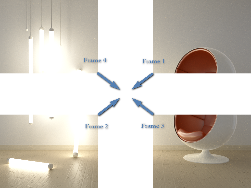

In this example I used Gimp for the stitching: With Ctrl-Alt-O you can load images as layer and then just place them correctly in the large image:

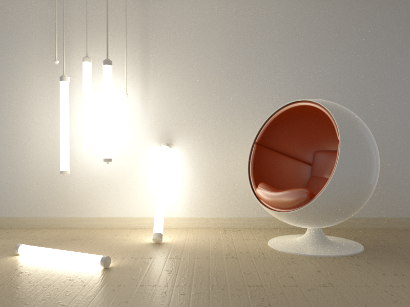

And this is the final result:
Look Mum: No seams :)
